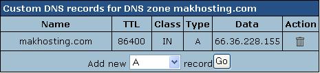

we found custom A records that were causing this issue. We tried recreating the DNS record via the HSphere DNS recreator tool, but that custom A record kept on showing up. We spent quite a few hours just looking at that problem. We paid PSOFT to look into it to and the problem ended up being from the reseller control panel
As far as the DNS issue goes, we did some extensive testing and found nothing wrong with the DNS record creation.

makhosting.com has two A records at the moment, it’s consitent over both your nameservers:
Addresses: 66.235.181.49, 66.36.228.155
The records I need all resolve correctly for now, so I ain’t touching anything that might get them out of whack again until the cause of this problem is resolved :frowning:
The DNS record is still in his reseller account. He needs to delete it and ask us to recreate his zone.
Yash,
I went to delete this record and it said “Internal Error, tech support was notified”. Any suggestions?
However, when flushing my DNS cache. everything now works just fine. All domains work and my mail is back online. I dont know if the a record was the problem. It is still there and everything now works after flushing dns cache.
Let me know your thoughts. And I appologize as well about earlier. You’re not the only one tired. lol. I was up untill the wee hours of the morning trying to get things fixed, not to mention clients calling with their issues. lol. anyways. let me know your thoughts on that error message.
I’ll look into the internal server error
The double A record is technically not a problem because the correct A record appears on top of the incorrect A record. But anyhow, its better if its deleted.

Yes,
Agreed. But as the error apprears I cannot delete. thanks
