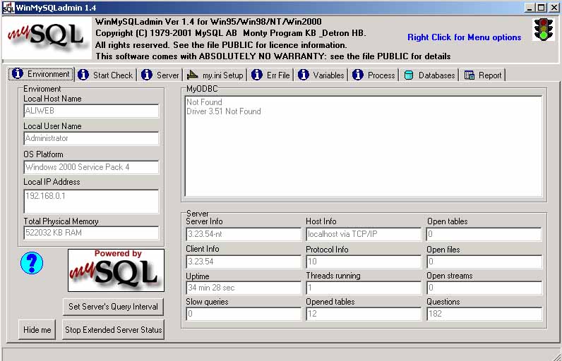

I have just installed MySQL 3.23 on Windows 2000 Server.
I am using WinMySQLadmin 1.4 to connect it to the MySQL server.
Can anyone tell me how to change the root or administrator password and default port in MySQL?
Check the attached file for a screen shot.

That screenshot is only of the engine info interface, you’ll need to use a seperate tool to change the user priviliges.
