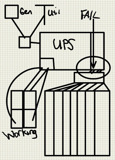

I’ve used my phone to draw up a little diagram similar to what has happened here. It is a bit lacking in ‘details’ but gives and overview, the unlabeled little box between the generators and the utility power feeds is an Auto Transfer Switch, there are actually multiples of some of these items but I’ve simplified it down to just one to make it understandable.
The 4 squares on the bottom left are the 4 racks that were working, as they had a feed directly from the UPS room to their racks, whereas those going via the subpanel (on the bottom right) were without power due to the master breakers on the UPS tripping due to one of the phases being over amperage limits. The circle with the Fail is the single phase that was over, being fed to the subpanel.
Just as a FYI for those curious, yes there are 4 wires going to the subpanel, as one is a neutral, since we are using them as single phases it is needed to run the wiring from 3 phase to single phase on the floor.
