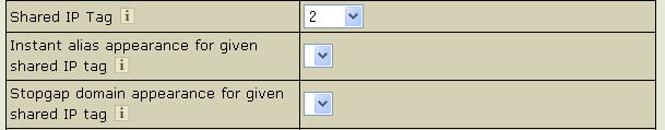

Yes I just did. I am attempting to create a plan named Personal for all of my personal non-billed sites to be classified as. The following error message resulted when I attempted to continue to the next page.
It just miraculasly fixed it self… I will come back in a sec with more info about this

I am not sure if the following images will show the source of the problem with my wizard… Before the first image is all I would see… This last time I saw the second image…
Yeah the 2nd one is how it should look.
So are you able to setup a new plan now?
