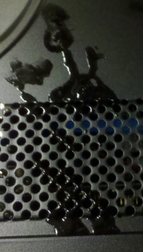

MySQL7 - water :(
We will be taking this up with coresite but not a good situation. We’ve never had/seen anything like this in our 4 years here. :frowning:
he said it seems like an oily water…not good either, but maybe not AS bad as water alone.

Already being done, it is very weird no pipes or vents above, just the 2nd floor beam above(way way above) this is all a mystery.
We also put some plastic bins across the top of the racks (this is 9ft up in the air mind you), so that IF something fell it isn’t going to easily work it’s way into server vent holes.
