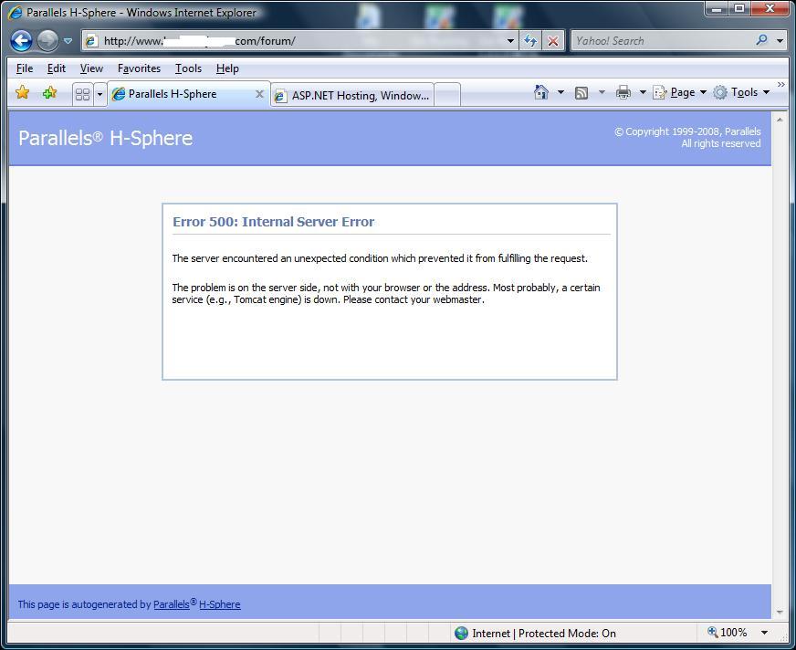

I have submitted screen shots with my ticket of the error message and still they tell me there is no error. I guess I just made the screen shots in Photoshop, idk.

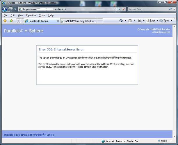

The error I get says “This is a server issue” and says that one possible reason for the error is a service like tomcat being down.
I don’t know what is causing this.
I get the error randomly everywhere in the website, inside the admin control panel, browsing the forum, browsing normal html pages, everything.
There is a screen shot of the error message exact text attached to my ticket. If it was an ISP issue I would think I would get it on other websites as well. I use the internet all day long for my job, and have never seen this issue on any website except my own. I am on the internet from sun up to sun down designing websites.

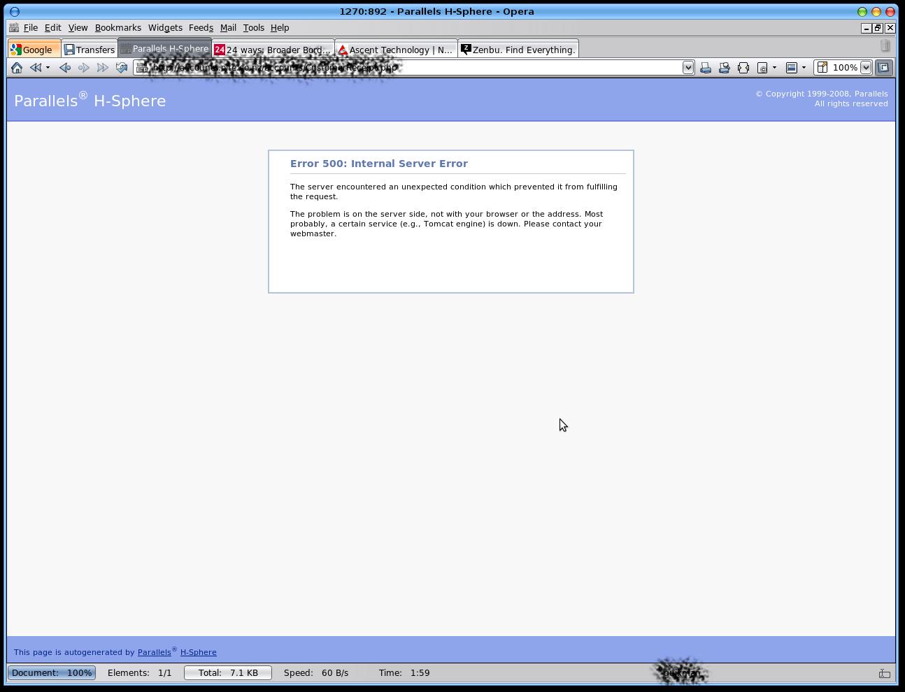

I haven’t suggested it is Tomcat. The error message generated by H-Sphere is obviously a generic one indicating some service is down. I am just reporting that I have seen the same error as Kensino, about 4 ot 5 times over the last 2 days.
Each time it happened, it took 2 minutes before H-Sphere threw up the error page (1 minute 59 seconds to be precise). The symptom only appears for a few minutes each time. I notice it happening while working using a back-office application (php) hosted on a sub-domain under my service account. So far I have identified that when it happens, it affects php scripts on 2 other accounts also hosted on web5, but not plain HTML pages, It also does not affect php scripts on web7 or web13.

@Kensino, they are not Tomcat errors. The are “Internal Server Errors”. The error description mentions Tomcat by way of an example of a service.
