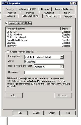

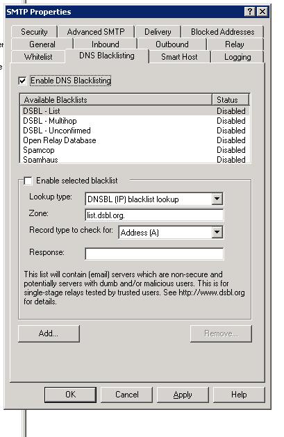

this is easiest to do within mail enable itself :slight_smile:
Screenshots attached.

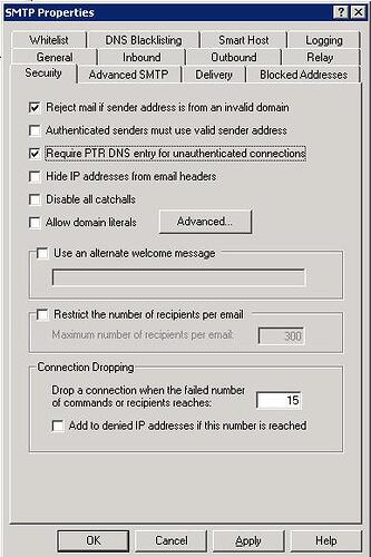

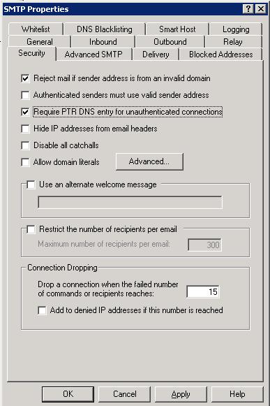

I found that part, but this is where it won’t let me select any of the tabs. For example, when I try to click on the “Security” tab, I get this:
There are two domains on this VPS right now, with more coming. Some use SMTP off the VPS, others have their own Exchange Server. So I’m not quite sure what to use for the valid domain name, so that I can get to the other tabs.
you will need to put something in here, like mail.maindomain.com
Ok, I just picked one of the domains and used that - seemed to work. Hopefully that will help with their spam.
