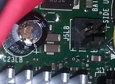

Mail3 is having to go into extended maintenance, on reboot the server did not come up and we checked there was a blown capacitor near the PCI-express slots that was leaking some gunk. This is obviously the problem and we are doing a motherboard swap now.
During the swap I found another capacitor under the pci-e slot also busted and leaking ‘acid’, so its good we caught this in a maintenance time instead of a random reboot that was needed due to performance we’d have been in a lot worse situation than the planned maintenance when I was here anyway.
The RAID card and drives are all swapped to new hardware and FSCK is running now.
Mail3 is now up and running well.
