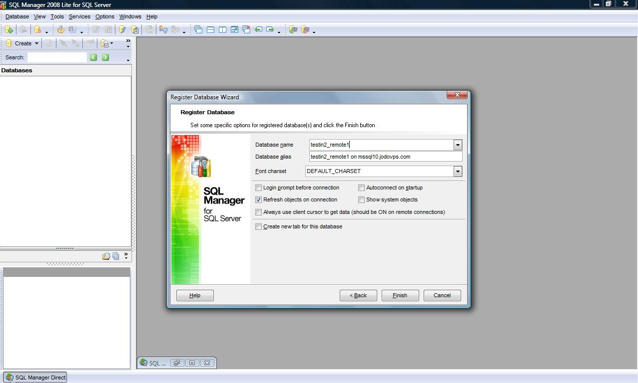

On suggestion of support I also installed SQL Manager Lite. I get the same issue. I can see the user I created, but not the databases.

On SQL manager you need to put in the DB name during the wizrd.

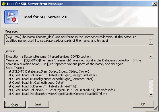

I just tried using TOAD for SQL. It’s a fantastic db manager, kicks EM out of the water, which really isn’t a big feat anyway. But it won’t work on Jodo’s SQL servers, because of this insane rule of not listing database objects. Sorry, but this is not a good situation at all.
In the first attachment below, you an see me setting up a new connection in TOAD. It seems to recognise the db object there and allow me to create the entry.
But then when I actually connect and want to see a list of tables, it comes up with that error in attachment 2 below. “The name ‘xxx’ was not found in the Databases collection.”
Come on Jodo, you’re supposed to be HELPING us, not putting hurdles in the way!
submit a ticket and we have a workaround for it, but it is manual for every request.
