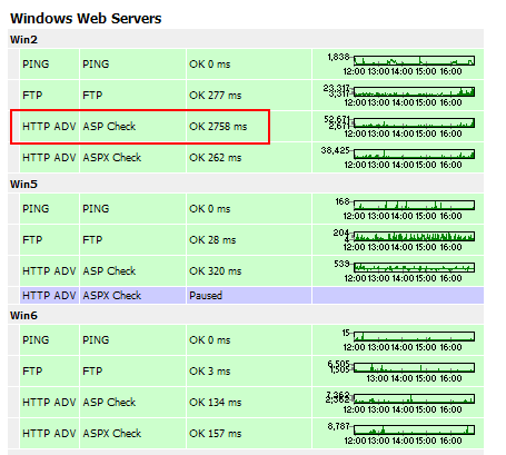

anjinho.. Win2 has been working pefectly since we fixed it yesterday.. the issue was due to some largish ms access databases being run by customers.
if you are continuing to face issues, please issue a ticket. You can see server respone times here:
http://jodopulse.com:8080/pubgrp?uid=76EE495F-1D11-4F06-A9CE-A5BAEB0EED3F
why is it that the ASP response time is still much higher on Win2 than it is on any other Win server?
what ASP response time are you seeing? its around 250ms right now and all servers hover around that amount.
It can fluctuate due to latency… shouldn’t be higher than 500ms…
500ms is actual page load time of an asp script..
I know it shouldn’t be higher… but it always is… just checked again.
We’ll keep a close eye on this.

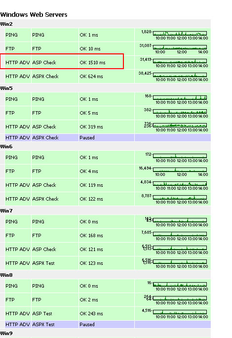

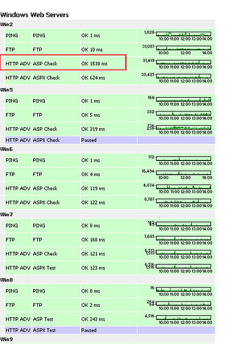

Win2 has been shaky all this past week (and if I recall even some of last week). It’s sometimes fast and sometimes really slow.
What’s going on?
(It’s not urgent so I didn’t submit a ticket, but I would like to know what’s up. Thanks!)
