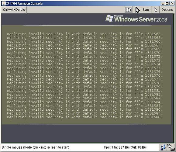

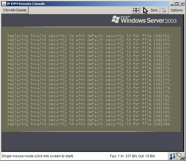

Attached is the print screen
Hello,
I am quite apologetic that this maintenance is still going on, however as you can see from the screenshot the security scan is fixing many errors that are being detected.
I have never seen before a stage3 of a scan do so much, it is typically one of the faster stages of the chkdsk process giving you a percentage complete and then continuing on rather quickly.
What happened to cause this was a few days back some abuse was really bogging the server down, and it was being so slow our only choice after 10 minute of work was to reboot the server, and ever since then it has been giving errors about needing to chkdsk and correct some entries for some awstats logsfiles. If did that in the first 2 stages of the process and now in the 3rd stage it is finding and correcting what seems to be large groups of files that were accessed between that reboot and now. It will sometimes skip a large section, then hit a section where it does many corrections again.
