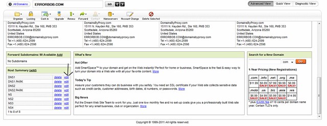

Host Summary on Godaddy. Some shots of it.

NO I say with full meaning of the word.
If you only go by server aliases you will be DOWN. Server aliases are our side of the equation, we are set. This does nothing to make the name server ‘glue’ or nameserver record to tie IP to name at registrar. It MUST be done at registrar without fail or there will be mega fail when the old IP goes off.

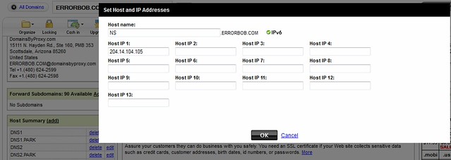

OH! Now I get it. I’m setting the IPs for the hosts I defined for my service domain at my registrar. Got it.

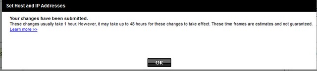

Darn GoDaddy will let me update only one at a time, then I have to wait while they process that request before I can update the next host.

naaa you only have to wait about 10 sec. I did all mine last night.

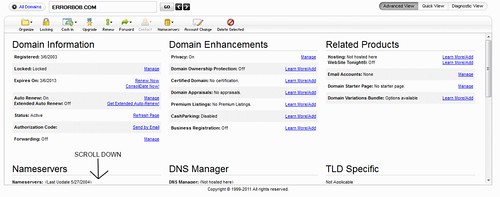

you should only have two nameservers on any domain, you can have many nameservers registered (look at my screenshot) but you only need to use the proper TWO on your service domain.
To get that, go to the domain in hsphere and in summary it will list the nameservers for your domain.
